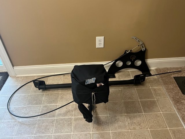

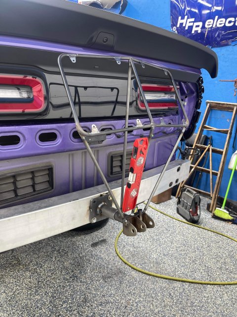

Carlin Fabrication in Calimesa Calif. They are making production mounts now for the Challenger and Charger. The mount is removable once the initial attachment to the frame is done. 2366A121-79DC-4454-A450-718FA96E72F5.jpeg

Perfect I’ll reach out to them Monday. Thank you.

Spoke to Jason, sounds like an awesome dude. He is able to get me taken care of. thank you!!!

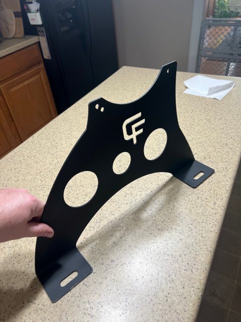

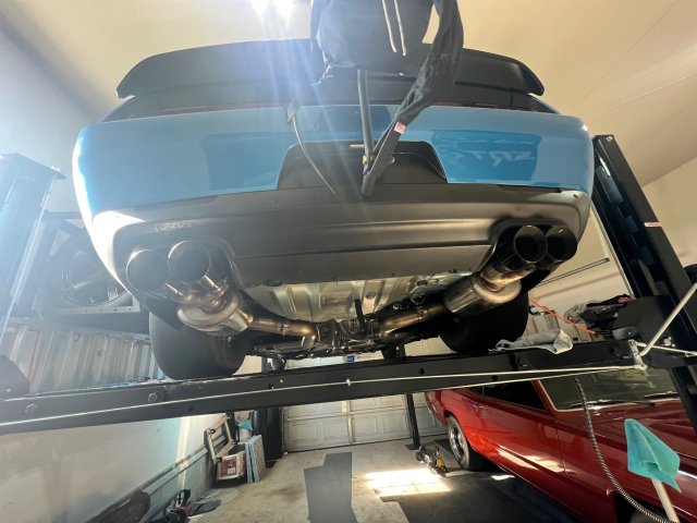

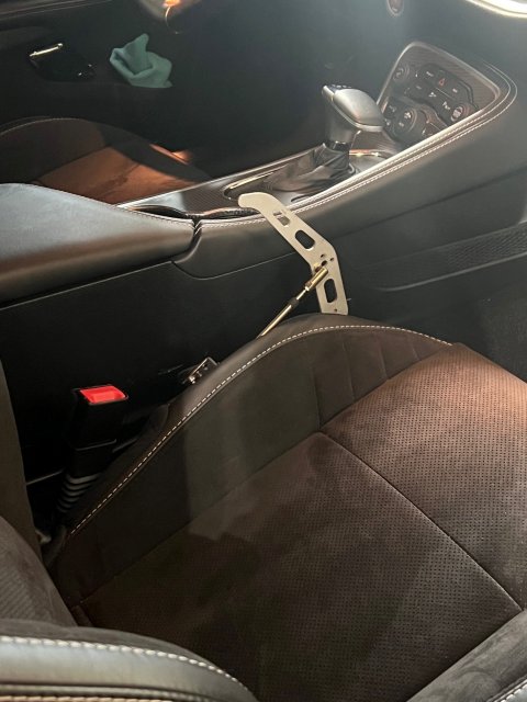

Received it and got it installed. Great product and service from Carlin! absolutely recommend them for anyone looking.

I saw your Facebook post. Looked great. I’m thinking I’m going to need one as well after I finish my ordering spree I’m on now…. Are you doing a cage or just the chute for now?

Chute and engine diaper for now. I love my car too much to put a cage in it. I personally think that's going to be my deciding factor on how far to take the car. The more thought I put into it the more I'm just going to stay around the high 8's for a while. I think my idea at the moment is to build a stock displacement bottom end with billet rods and diamond coated pistons a set of good ported heads and a custom spec cam. Make it capable of mid 8's on boost. While still being a reliable street toy.
