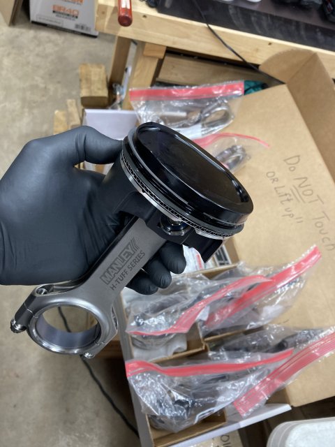

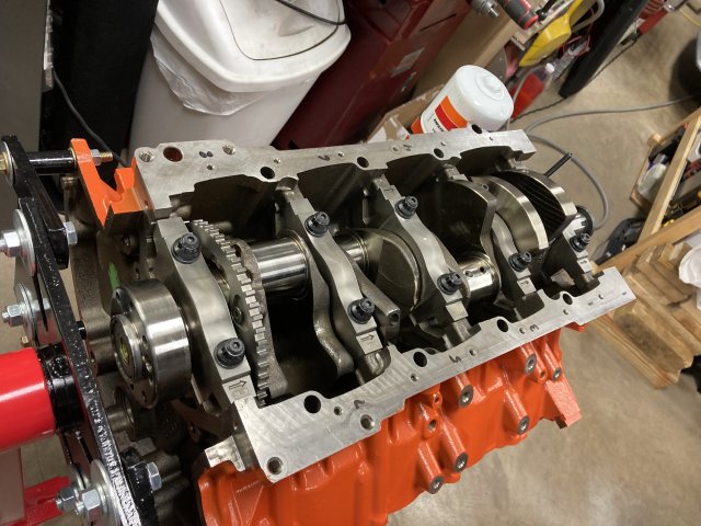

Here’s what we’ll be working with next
FB15CF9E-B003-475B-A49F-3323D3F334DC.jpeg BC90EEE6-4575-460B-878A-7BC2CEA2F185.jpeg
