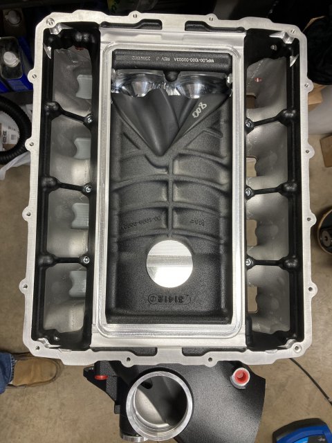

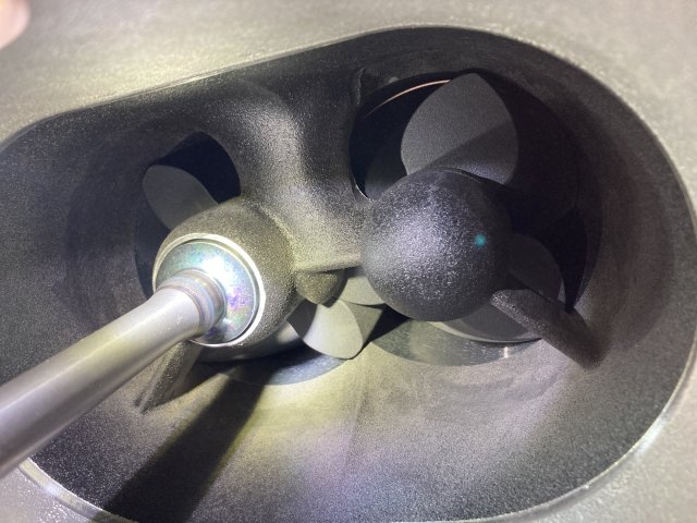

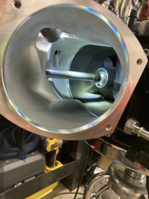

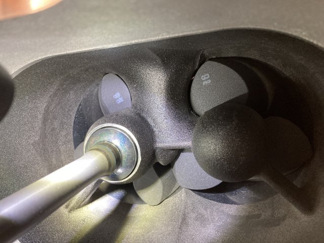

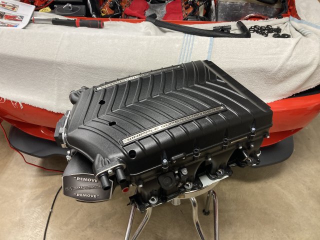

I got the first one :)
I Was making 950 wheel on my ported 2.4 IHI 2.72 upper + 10 lower IHI before on pump E83 so we’ll see where this gets to on about the same boost to see how much more efficient they really are
1906F4D4-4027-470C-BD75-315BAD6BD6E3.jpeg 11C5D330-7C59-4A51-A085-BC02CDE7F981.jpeg 5668EE7C-11E3-41E9-BF52-66AEBF68E299.jpeg 0D0F1DCC-C72D-46CF-9729-3519D639A16F.jpeg 690ED094-F544-41D1-BD5F-FBE5E4C96FAE.jpeg 0AF6A439-289A-4051-B36B-397EAC107B8F.jpeg 815A4E7D-6AC4-4355-A771-3040A32F2F7B.jpeg 1039EB88-C02D-4555-938C-FB93A1B1396B.jpeg DB65FC8A-B579-464D-A10C-136EB1C7CCB0.jpeg 0EC5AD3E-C93B-4EDF-9808-AA4D018A36AD.jpeg
Should be on the Dyno next week If all goes right.

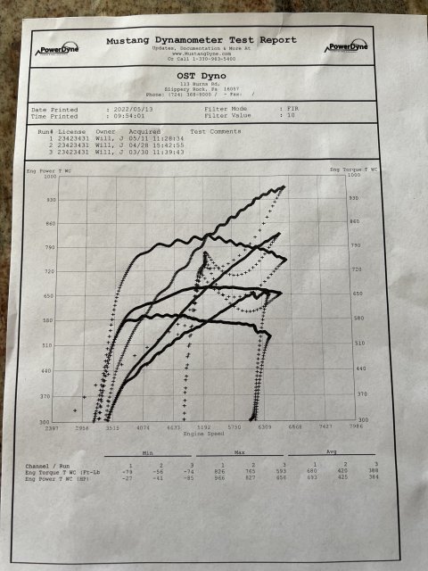

3rd pull on the sheet is a bone stock 2.7 IHI. 2nd pull is the Whipple 3.0 and 3.75” upper at 18#. 1st pull is with the 3.0” upper at 24#. 21 SS, A8 in 5th gear, 3.09. Don’t remember the timing, but I know it was VERY conservative. 6th gear would have put it over 1000whp.

assuming that was on gas?

Stock pull was 93, 18# pull was drum E85, 24# pull was E98.

Is there a lower on it? I wouldn't think the 3.75 that comes with it would make 18 lbs of boost

NICE numbers!!
Stock lower pulley??
I can’t wait to try mine!!

Yes, stock lower.

That’s making some big boost on a stock size lower!! I have a 3.00 lower I was planning to use but driving it with a +10 lower, I only want to start with my same boost I was making before for now, 21-22 lbs, I may have to start off with the 3.75 it came with for the first runs.
What size injectors and fuel pumps you running?

ID1300’s and stock Redeye pumps.
Isn’t your motor worked over? My motor is stock, so it’s probably pretty restrictive and therefore building more boost. I’m also on a full stock exhaust. I would think better heads and a less restrictive exhaust would flow better and build less boost, but I’m also still learning. I’ve only known n/a my whole life.
