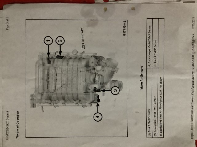

Thanks, I hadn’t seen that diagram.
However, I’m still not sure which of the 4 sensors the code is for... looking up the DTC, it calls out the intermediate TMAP sensor (#2 above). The ‘bank 1’ sensor is called out as #1 in the diagram above. And the Dodge service manual refers to #4 above as the ‘bank 1’ sensor.
I’m so confused...
I’m so confused...
Well they are something like 40$ or less a piece. Might just want to change all of them so they are of equal age. Would save lots of headache trying to figure out which is bad when one or more may be acting up. I would pull different codes indicating a different sensor occasionally so upgrading all 4 is my current route.

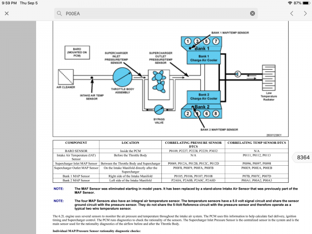

Found this which appears to confirm its the intermediate TMAP. I’ve already got one inbound, so may just replace and see if that takes care of it for now.
