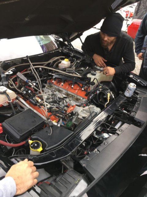

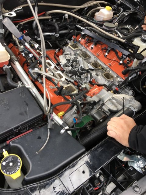

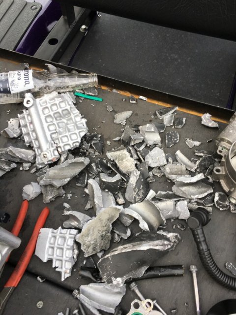

Here are a couple of pics from a Nitros Express user. This is what happens when forgetting to turn the NOS OFF during a burnout!
14,718
45,214
4,664
33,012
Of course it is.....that's just a few pics there are more times!
