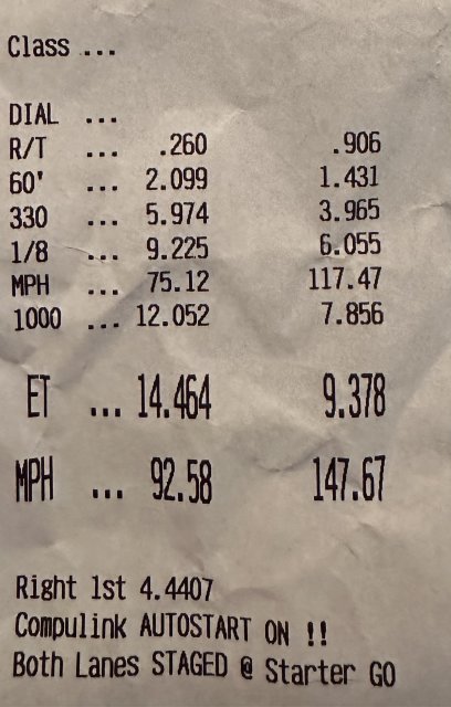

New personal best!

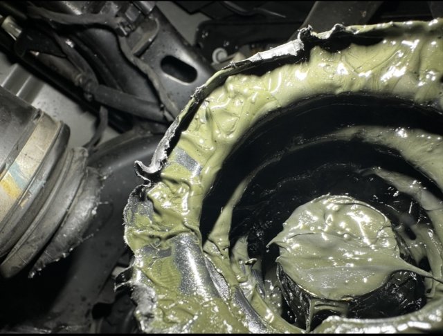

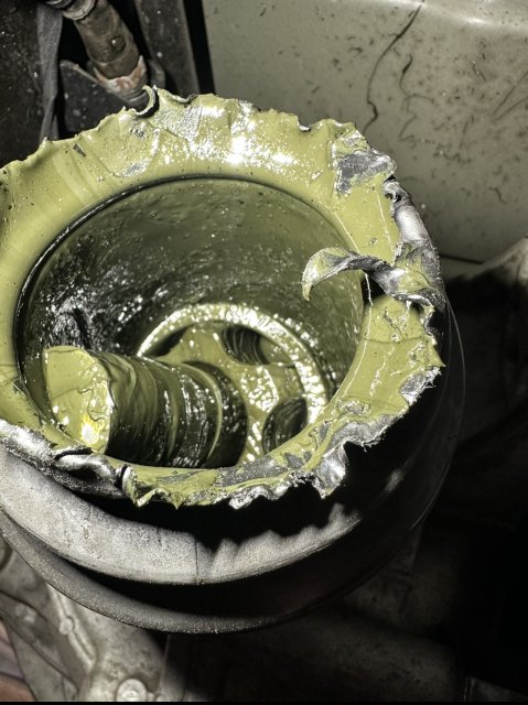

Awesome run, now that's smokin'!
Bummer about the axle :(

You're lucky you have some axle poking out of the carrier... trying to get a piece out without anything to grab on to is a PITA!

Thanks! Popped right out, I'm not sure I'd call it luck lol. More bad luck than anything that night

great job buddy. in my personal experience. The redeye and Demon axles break just the same. I've had the DSS level 5's in my car for 3 seasons now without any issues. Multiple 1.1 60's countless 7 second passes. buy once cry once.

Thanks! Nowhere near as fast as you, but hoping I can eventually get in the 8s with the 2.4 IHI. That's the way I look at it - hopefully won't have to worry about axles ever again. Just everything else 😆

Thanks @Speedy! ! Had no idea what to expect with all of the work that I've done to the car this time around. I would have settled for a 9.5. This car continues to surprise me. The gains seem to be a lot more than I would have thought.
And unless my boost calculation is wrong (not sure if it will calculate correctly with 2 bar sensors) I was only making 17.75 lbs of boost
Your 2 bar MAP sensors are probably pegged, mine in the past when running a ported 2.4 blower yet they top out right around 17.75 like you are seeing. Your probably making more boost then you think. You need to upgrade your 4 Map sensors with 4 new 3 bar units. I may have a set of 4 from a Redeye blower, let me know if you need them and I will look for them.
