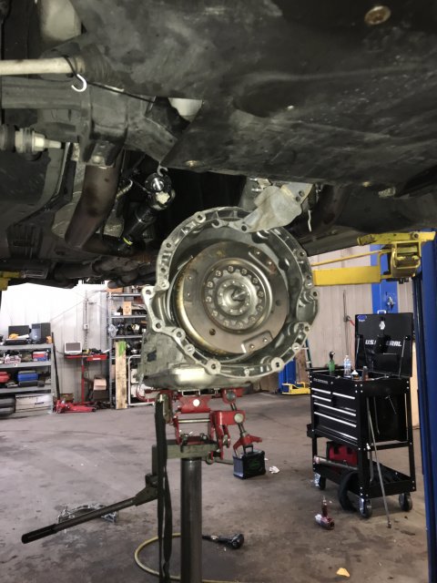

you can’t fill it with the engine off, has to be running or the fluid will just pour out. It’s a pain, I had to top mine off after I did trans swap. You have to run it through the gears put in reverse, neutral and hold at a certain rpm to get everything to fill correctly all while pumping in fluid until it drips out. I put my wife up in the car in the car on my maxjax to run through the gears for me while I was pumping in the fluid, she was scared to death lol

What happened to stock trans? No way you should have needed a new one at your power level
Stock trans was a tr6060 😎

Not the normal path. Why not buy an auto car and sell yours?
Grudge racing. Never saw it coming.

Not to mention the invaluable knowledge on the platform gained by doing it

Looking back, I should have just went with a th400 with a gear vendor
