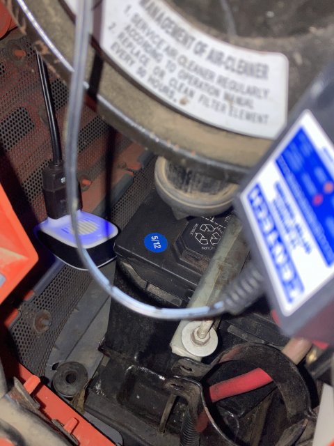

Been using HF float chargers for over 10y, I have not has a single prob and everything have been working flawlessly. I checked the bat I use for my dump trailer which spends 99% of it's time in my shop on the HF, it was drawing 5ma at full charge.
