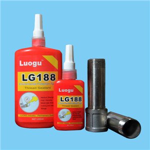

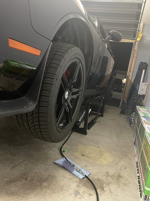

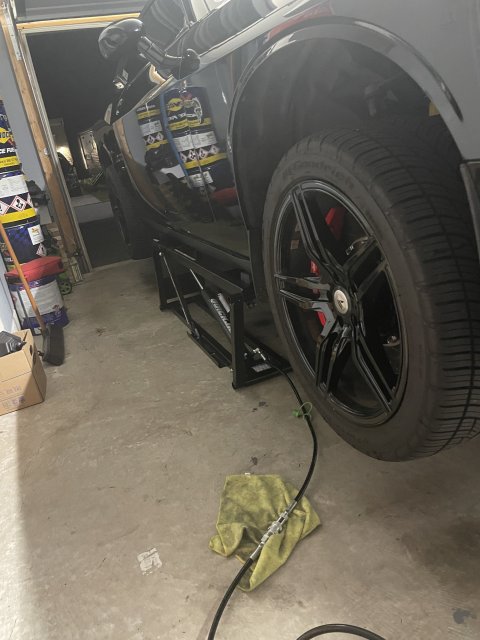

Setup was relatively easy. Operation was easy till I saw every hose leaking on first lift. In the kit they give you a bottle of thread sealer which absolutely does not work.
I redid every hose with PTFE thread sealant tape and not a single leak. Now I wont have to deal with jackstands anymore. I have the 7000SLX models. I do have to call Bendpak as they sent me a extra rail… and yeah um need the space.

No issues with mine but I used teflon tape as well.
4,034
10,003
I have been using mine for about 3years now. I actually leave it under the car. Then just pull out to lift whatever car I need to work on. When changing 4 drag wheels twice a week it saves tons of time.
Im going to start doing this as well. Just means ill have to back in and use the camera to ensure I’m center.
This was the fix, threw that liquid stuff in the trash.
Their connectors suck! I will agree. More than once I have had a failure, lots of fluid on the floor, and had to go buy new parts. Plus they are a bear to connect together.
20,157
If everyone is shit canning the liquid seal, why do they still send it out? Counter intuitive to me, unless it comes with the "package" they set up with Alibaba/Communist Walmart. Stuff is made in China, I believe.
Odd.
Did not get sealer, but also, have no leaks.

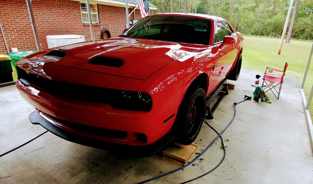

Love mine.
As I have Mopar springs, and got the extension adapter (so jack actually contacts front and rear lift points), I made wooden jack stands to drive up on. 0905211325.jpg

Taped all mine because I always do.

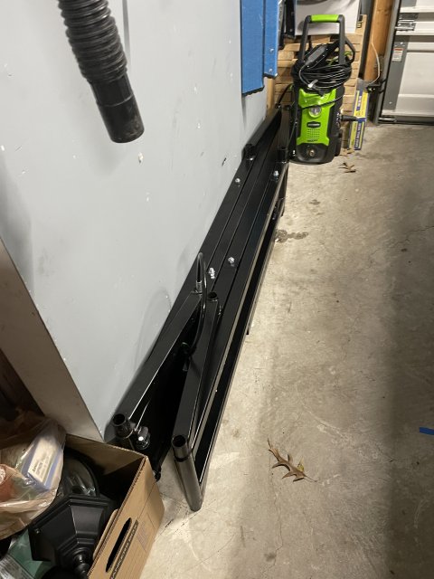

Thread Starter #20

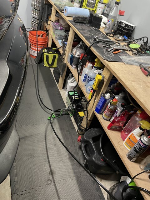

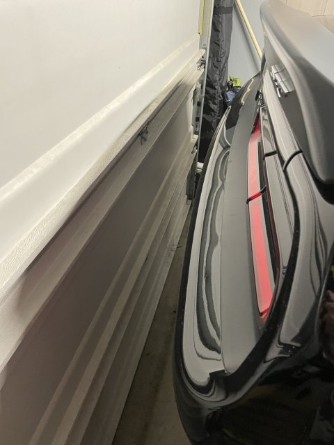

Permanent location of pump and cable route. Also figure out radial shift and storage.
1903B8E7-5965-4E6A-A191-93589A0419AB.jpeg E54D6B9A-AF80-47AC-A5CB-85E697C575E6.jpeg 7446CF33-6290-490C-A6C5-A0877A7BAAC5.jpeg 87C38CF5-B87F-4195-BE7E-C5FB7794BC09.jpeg
