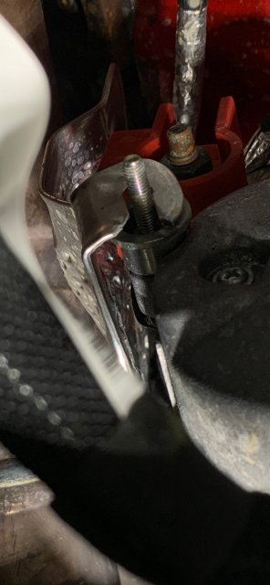

Good morning. Not many automotive things going on with the nation in an ice box I noticed. Let’s discuss what may cause a knock sensor to believe it has a problem.
I have the Redeye up on the QuickJacks for its annual detail and maintenance. While the belly pans are off, I always touch everything I can. It is an instinct and technique learned from owning and riding a Harley Davidson motorcycle and certainly when I built and rode a custom chopper. Just casually wiping everything, and listening is a good time.
DING, RATTLE, RATTLE! I believe someone has seen the same problem, but I can’t remember who and where I saw the post. So, let’s make a thread. @DodgeCares you should pass this up the line. That little stud is too small. I have no idea what was on there before, but I had to find a couple of nuts for it in the “weird stuff” boxes. I have seen child’s toys with larger fasteners! Give me a break. The sticker on this car was over $92k. This is your premiere engine. Yes, I know it is the same starter as about any V8 has, so do a better job!
SOB is fixed now and double nutted. What I would like to know from my friends here is do you think a knock sensor may have been hearing the rattle this thing was making?? I will find out soon enough, and report back here once we have it out again. Until then, what does everyone think? Stay warm because it is going through -20 here this morning outside.

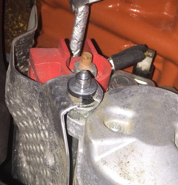

I noticed this while pinning my crank this winter. I assume the heat shield needs to be slotted to allow the heat shield to move as the engine twists. I put a rubber plumbing washer on each side of the heat shield and used an M5 nyloc nut to just snug up to it. This should decrease any chance of rattle.
This was my post with several reply’s, apparently they are all this way;
https://www.challengersrt.org/threads/while-pinning-the-crank.8055/ 07D2275D-23C8-4B07-9A30-9854F94E3A04.jpeg

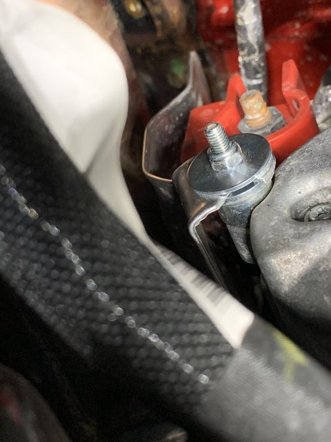

As per 2017 Redline HC's pic, I've assembled the parts and will install once I pull the Charger out of winter storage. stainless M5 locknut and m5 25mm (1 inch) washer and two 1 inch outdoor hose washers.
I've had gravel in behind the front wheel frame rails making a racket before, but I still get the occasional rattle that goes away once I stop and restart the car so I suspect this is next.

Sandwich with nylock frosting. Done!
