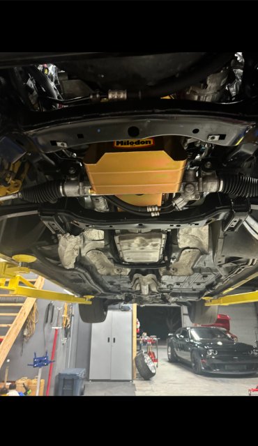

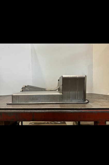

They will fit the pan will just need to be trimmed, all the aftermarket/sheet metal pans have to be clearanced to use them. I believe it is only about an 1/8th of an inch. i have attached some pictures of there the pan needs to have some material removed.

Here is where the pan was trimmed so the rear supports could be used. Milodon will be making an adjustment to their tooling so the future pans are already notched to use the braces. IMG_5632.jpeg IMG_5633.jpeg

I wonder if the Holley one fits. The MMX ones are rediculous for what they are and have half the mounting points

The Holley one is a definite win over the MMX one. Not only does it look better, is a hell of a lot cheaper, but it also covers the flywheel like stock protecting it from debris.
Also, from the photos, it looks like it will fit just fine with the same trimming down here for the MMX ones.
