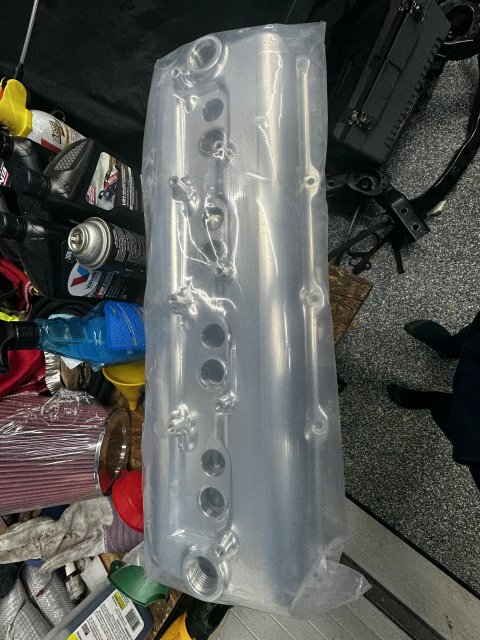

Manton new valve covers fit like a glove.
Hatermkr
#15491
1,279
2,652
West bend
2016 helldemon
use factory gaskets ready to bolt on. Can’t ask for a better product for the price.
don’t buy the copies buy the original

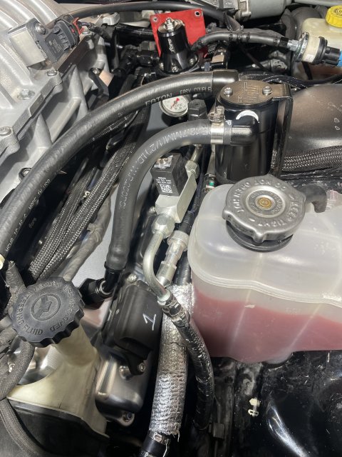

Semi buttoned up. New an lines on driver side. Spent 48 hours thrashing, wouldn't have it any other way. Time for bed, gonna do the coolant side during the week.
