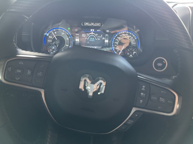

My friend bought a new Ram in Phoenix, AZ. He lives in Tucson. The truck is only one month old. So this past week they, him, his wife and twelve and fourteen year old boys, took a trip to Flagstaff. They stopped off in Phoenix to grab a bite to eat. As he pulled up in line his freaking front driver's wheel fell off!!! When the tow truck driver looked at it they discovered the bolt from the upper control arm was missing!!! A week before my friend noticed the steering wheel was off. He brought it in to a local dealership here to get it fixed. They did an alignment. But apparently they did not see the bolt was loose or missing. Thank God this did not happen at speed!!! I have never heard of this on a new truck! What is going on with quality control??? I will post a couple of pictures. He gave me a ton of them.

He said it was off. Picture attached. Then he brought her in for an alignment. If I said loose I misspoke.
