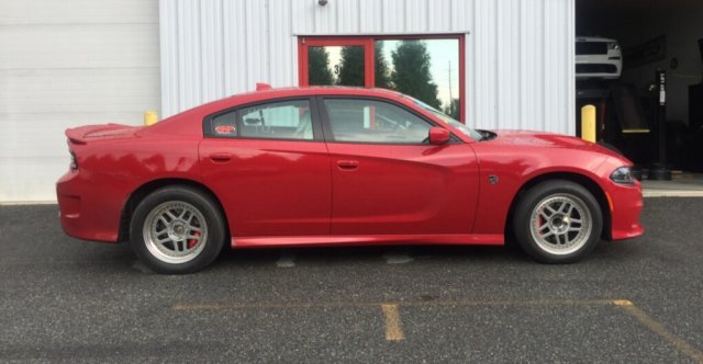

Mike Comp T/A #57
#1055
90
Batavia
Leave from an idle.

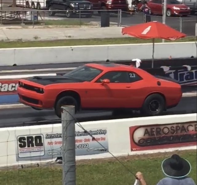

#1487
89
141
ellenton
2016 mango hellcat challenger

Whoa, crap! Now THAT is hooking! 15" conversion in the back? What is done to your suspension and/or rear end to support such a nice launch?
#1487
89
141
ellenton
Demon Springs - 15" conversion - 315/60 radial pros - stock 2.62 with brace - Sphon adjustable arms - and my own chromoly toe links

When you guys say idle, you’re not even pre-loading the drivetrain?
Correct - no preloading
