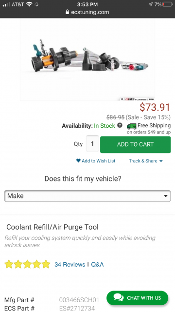

I bought one of these for when I finish my FI spacers and blanket install.
I’ll post the link in case someone down the road needs it.
https://www.ecstuning.com/b-schwaben-parts/coolant-refill-air-purge-tool/003466sch01/
does the use of this tool require me to drain the complete system first?
I don't know about that particular one, but I've heard nothing but good things about vacuum fillers.

I’ve seen nothing but good reviews on the website I bought it from (ECS tuning), on YouTube and on amazon. i think it’s one of the best quality lower priced models you can get. The parts are robust and don’t feel cheap at all.
I had been eyeballing this thing for years too!!
I’ll let you all know how it works out.
I need to figure out if i have to drain the system before using it, I don’t think I do, just want to be sure.

the premise of this tool is to create a vacuum in the system that removes All the air. Then at the flip of a switch it holds that vacuum while refilling the system with coolant.
im wondering if I need to drain the system first before using the tool because if I don’t drain it first I can see the tool sucking out all the coolant while its attempting to create the vacuum.
Yeah definitely. Post results, good or bad. Like to know how it holds up with coolant and underhood temps for a period of time.
im a little confused with your post. This tool doesn’t stay installed on the car. Once you refill the coolant youre done.

im a little confused with your post. This tool doesn’t stay installed on the car. Once you refill the coolant youre done.[/QUOTE]
Thought it was an air separator like Hickster was talking about, but was plastic instead of brass or stainless. that's why I asked about the durability with coolant and under hood temps. Now I understand what it is.
Yes , pretty sure your gonna drain the whole system (I'd say in a bucket) & pull a vacuum & refill making sure you have enough in the bucket to refill it.
