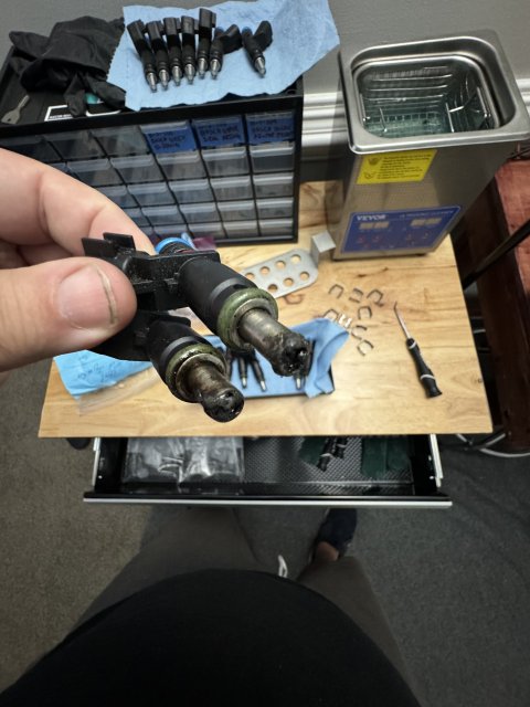

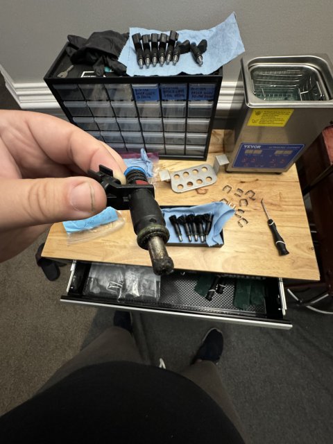

Customer was having issues. The car was stumbling. Initial inspection.

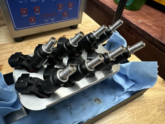

With injectors this dirty I like to let the intake end soak in gasoline for a half hour.

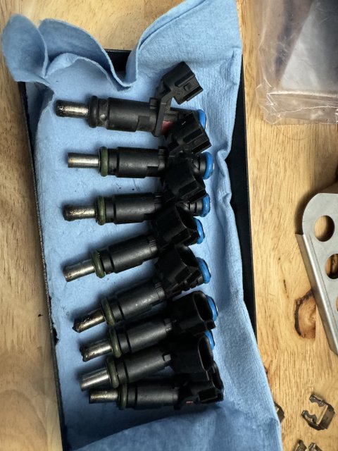

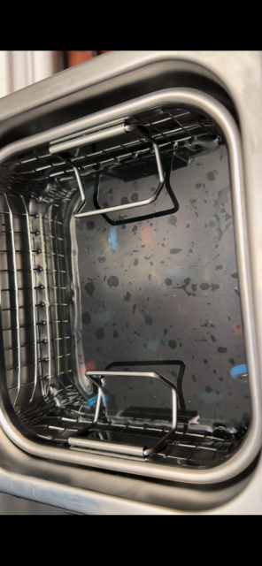

After three uktrasonic baths they are finally clean enough to hit my good fluid and be flow tested.

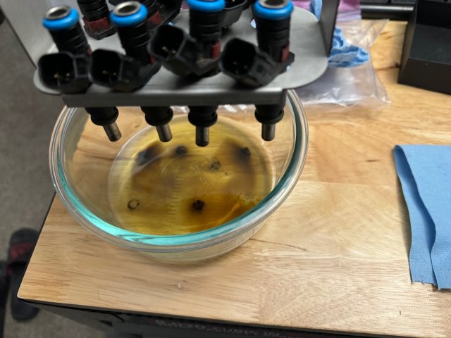

In case you wonder why I clean so much before flow testing. I use some pretty solid calibration fluid, this was the injector cleaning fluid after bath #1
Turned the fluid black. Don't want that in my testing machine. But they are ready to flow! Remember for the rest of the year, 100.00! All 8 injectors!

Those were filthy! Any idea how many miles on them and what fuel they used?
3,533
8,608
Customer is a procharged 6.4 Charger running e85. Built bottom end but has no inclination to go faster. Its his weekend fun car for him and his son, says its just fun having an 8psi charger for those that want to play games thinking he’s stock.
These are factory Hellcat injectors. Our assumption is without a properly vented catch can to atmosphere the cylinder was retaining moisture and gumming the injector.
