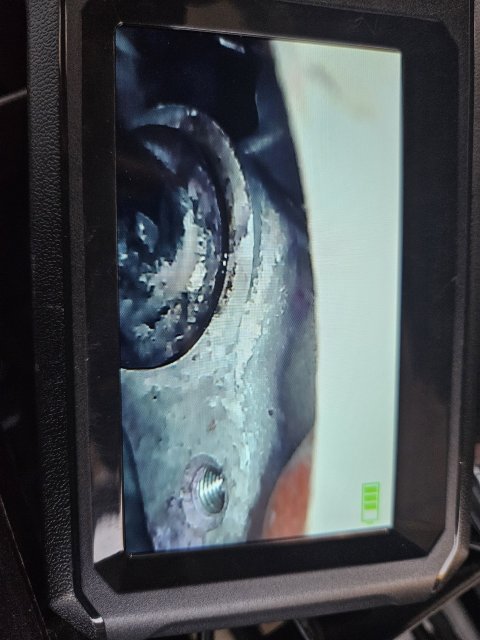

I have a coolant like from heater line
See pictures below:
a view from endoscope camara where the leak is
Can this pipe o ring be replaced without removing the supercharger?

The metal coolant lines are bolted onto the back of the heads. It may be possible to pull it out enough to change an o ring but I would just remove the supercharger
See pictures below:

It has an o ring, replace it

It’s 1 simple bolt on the back of the head but the noise sensors or whatever are on the same stud. Disconnect battery, undo nut and change it. Put lots of rags under so coolant doesn’t get under the supercharger and sit in the valley
