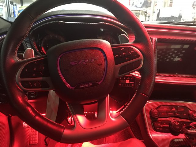

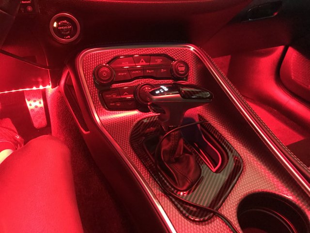

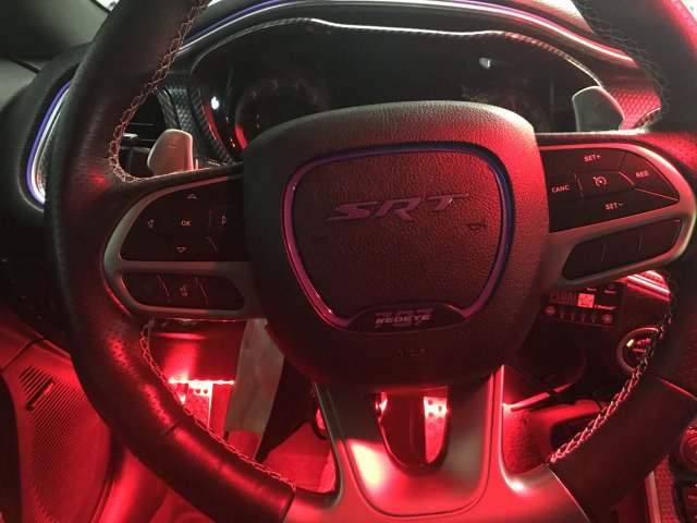

@Matt someone with an SRT we think alike. I really like my red LED’s in the interior. 8461F48A-B758-4BB4-89EF-B0AA71153631.jpeg 1FB8AE12-1DF4-438B-AB46-2FF8DBB43337.jpeg E3381AD1-BF0F-4F6C-976E-00050A9DB558.jpeg

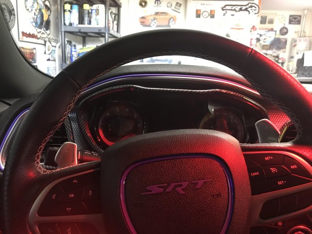

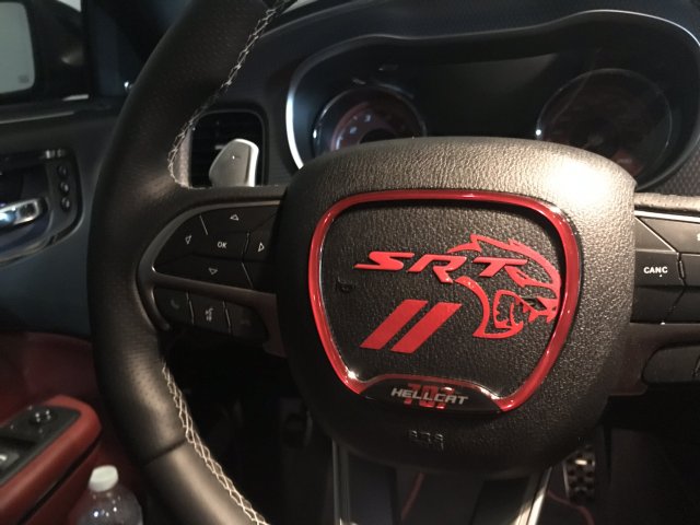

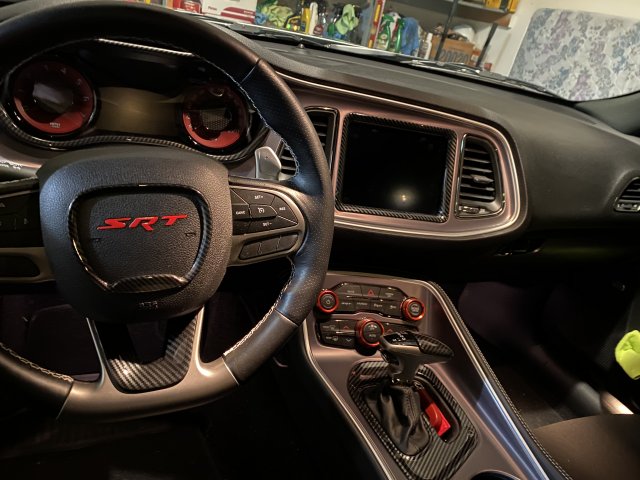

81175F31-4CF0-4AA9-A28C-4EEE828F7981.jpeg 9559D0DD-BC66-4A65-AB52-425C5A1405E8.jpeg C4BD9971-CE84-4679-8F26-05CB4BD73A7F.jpeg
