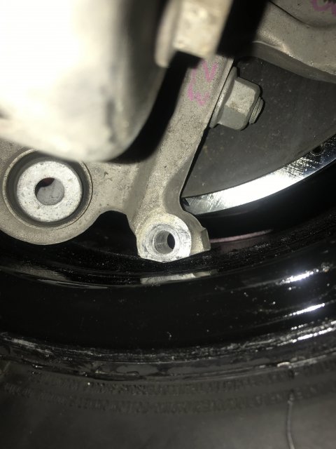

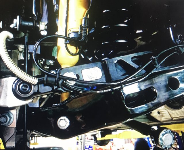

They have a new adjustable toe arm for the 15” conversion. Prior to this there has been a fair amount of grinding required to clear the inside of the wheel. I have the BMR toe arms with the “skinny” end joints for the conversion and they still needed to be ground down some.

Yes as I will show in my pics there is a lot of grinding 😕but a I say ( it is what it is)

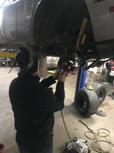

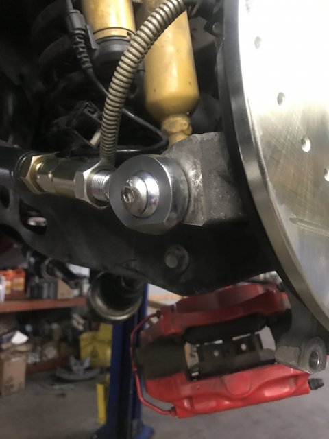

9A49DD3C-DA5A-4BCE-BF61-1BDE230E9775.jpeg As you can see here I started with a cut off wheel to cut the lower part of the sway Bar link where it mounts up this was fairly easy with a cut off wheel

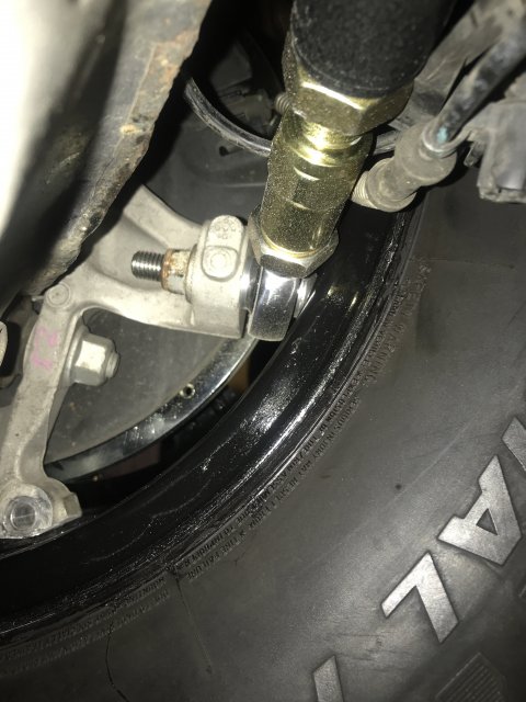

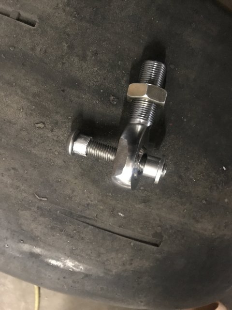

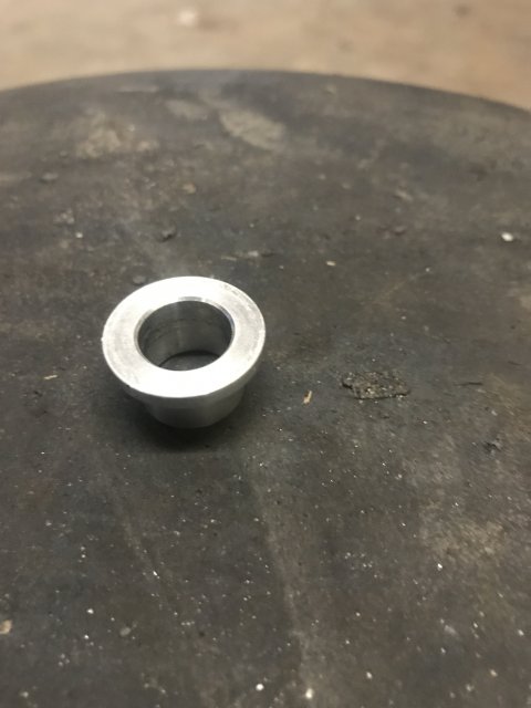

1DB49D37-F55D-4F75-9ACA-BE67AC2E7204.jpeg If you look at the picture with the little bushing laying on top of the tire I cut the top of the bushing off with a mushroom head is this allowed my toe bolt to have more clearance between it and the tire I also had to grind about a 45° angle on the bolt it’s still on the head,By cutting the mushroom top of the head off the bushing it allows the bolt to go flush with the tow arm A19BE940-F261-40D2-8147-5D5D35992B79.jpeg CF53D030-22F7-4F37-8776-CD7B8A4BAA0B.jpeg 8514ACC0-3346-472F-A43E-FEEFC12954DE.jpeg
