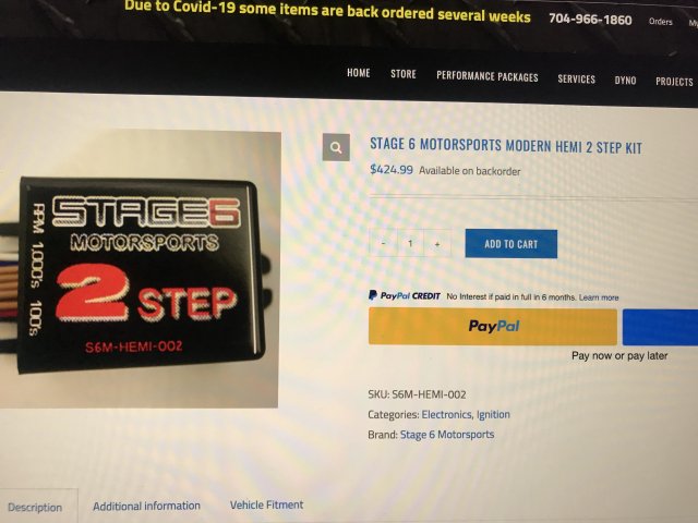

I checked with them and they told me that it only worked with the brake pedal on the Charger. Plus I wanted a lower stall speed than 2K.
3,500
11,266
We’ll the word “only” is not true. They are using that brake electrical signal to activate the switch and that works but I don’t see any point of using one without a transbrake. This combination is way too much all at once for anything but a properly set up drag car that can put a hard launch to the track. Hellcats have a difficult time with that as is.

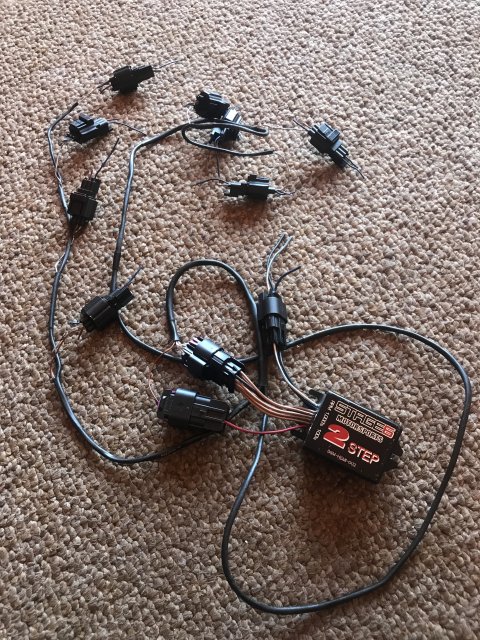

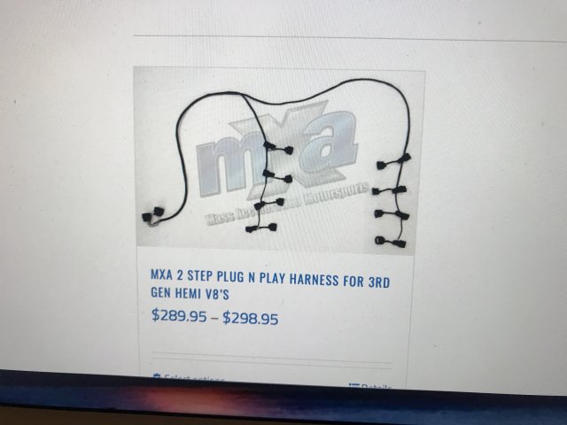

I have the 2-Step and plug-n-play harness that simplifies the installation that I no longer need. It worked perfect in my car. Retail on the Stage6 is $425 and the MXA harness is $300. I’ll sell the whole thing for $400 shipped. 2384CB80-1D40-4A4F-82A3-77BC14F82709.jpeg 741E9B04-48D4-47C8-95B2-7318C38735F2.jpeg
