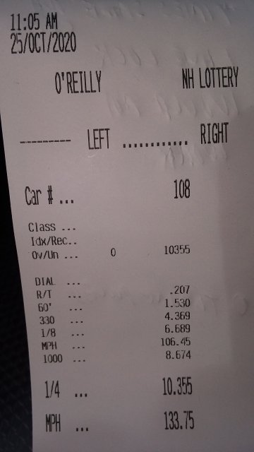

I did this with a 2019 Charger in 2020.Well worth it my opinion.Remote tune from Josh at HHP. Stock boost 100 octane tune running 93 with Boostane.Back to back runs attached. Da -1250. Also ran 183 in a mile. 20201025_115211.jpg 20201025_100225.jpg
