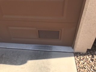

No question. An insulated door will be better than a non-insulated door. I have seen small screened louver’s installed in the bottom of a door. Maybe you could insulate it and use a floor fan to exhaust the hot air with those kind of louvers in the door...

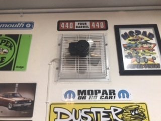

Before the split level went in we tried the exhaust fan up high and the inlet vents down low on the garage doors. It was better but in the end we went with the split level.

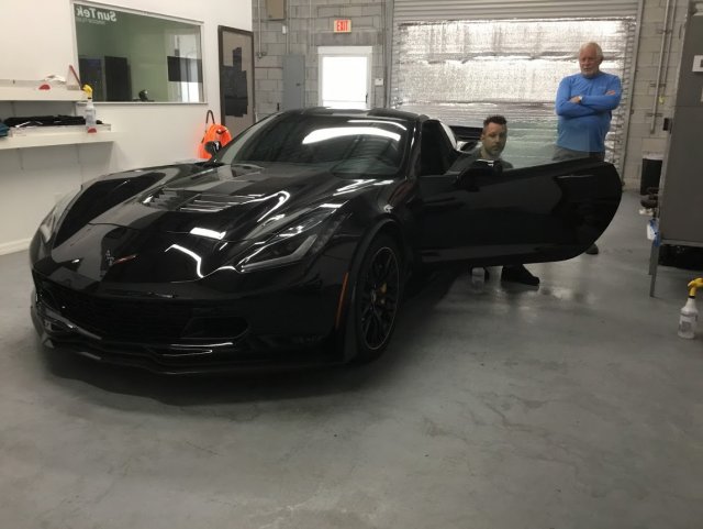

I would pick up a couple of sheets of the foam / aluminum sandwich stuff at Home Depot....try it. I did the bubble wrap on this roll up door at my kids tint shop It helps
I've thought about that too. My doors face west, so the sun blasts them all afternoon & evening.
Figured that stuff is easy to cut & should slide right in under the hurricane bracing. Maybe a dab of construction adhesive here & there to hold it against the door.
$60M question would be - will it add enough weight that the door springs will need to be re-tensioned ??
I have the styrofoam insulation with silver foil on 1 side and white foil on the other side. I've installed it on a 2 car garage door and a 1 car garage door and the openers work great. I can't tell a difference. The sheets are super light as you could guess.
They are also super effective. I've had some 90 deg days where the garage inside temp is around 73-75. The ceiling and walls are very well insulated too. In the winter I need heat, but I can just about get by without AC in the garage in our summers.
