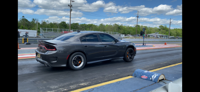

Headed to Island yesterday with a few guys. Beautiful day to be at the track. Prep wasn't bad, temps were hovering low to mid 70's, humidity around 50%, and DA at 2000. First time drag racing this boat.
18 Charger HC with LMI, upper, injectors, tuned by Barth, diff brace, D5s on ET Rs. I was full weight and on pump 93. I got faster as the day went on. 3 runs only before track closed. [email protected] (1.60 60ft) was the best pass. Got bad shake on the top end after the tires started to spin on the rim. Next up, trip to Atco with some negative DA and weight reduction.

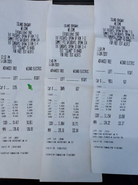

I started with 20psi cold. 1st run spun down the track.
Pass 2 and 3 I adjusted to 18psi and seemed like the ticket.
Pass 1 & 2 were off idle. Pass 3 was about 1200/1300 launch.
I can post slips if anyone wants to see.

Always post time slips , lol , & is best to at least take slack out of drive train at launch & maybe track prep wasn't that great ?... but should not have to be below 20psi.

All 3 passes. I'm car 637.
5,197
9,654
Nice , #3 1.60 60' is good & when you were at 1200 / 1300 rpm , you can try a little higher rpm next time & might do better. And depending on how much time between passes for cool off ? … keep eye on tire psi & adjust as needed to be consistent with psi , the faster or not you make passes the psi will be different.
