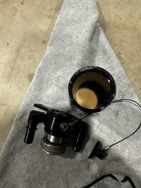

First time emptying catch can since chiller
8,283
7,203
Coffee anyone? Reeks of e85. Has espresso consistency. About 300 miles with chiller, dozen or so track passes. Before the chiller it was always empty. Interesting. UPR is the only catch can to have

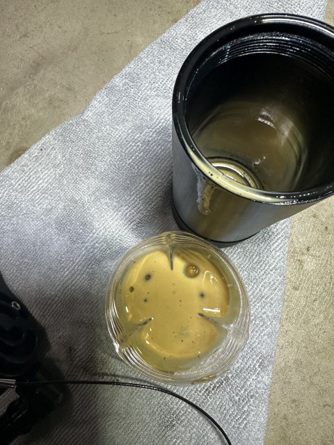

Because I like you guys and you all like science, a better look. You can see the fuel separated from the rest of it

It definitely seems like e85 but maybe it is water. Smells like pure e85, there’s a decent amount of liquid and it will not mix with the coffee
3,662
8,605
Put a match to it and see if it burns. When I poured out of my catch can it burns clear, you can’t even see it burning

Wow yep I didn’t even realize it was on fire until the plastic bottle started warping lol whoops. Wish there wasn’t so much blow by in it. That’s just in the blower/passenger side, have nothing on driver but have a oil fill vent

Its water. I open the pet cock to both of mine every week and watch the water drain out. Ill clean it out after a few times when all the gunk builds up.

Nope, it’s in the catch can like that. I get hardly any oil in mine, Mostly just a crystal clear liquid that some people think is water but it’s not, It’s almost pure alcohol. The water is what is in the foamy white gunk mixed with oil.
