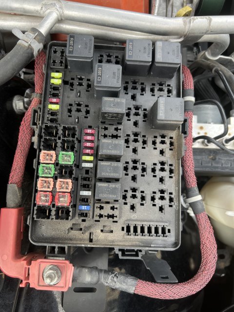

Am I missing any fuses or relays?
AlleyCat
AlleyCat
#1332
970
854
Oro Valley
16 HC Challenger
Thread Starter #20
They look all there compared to pictures on the net. The 50 amp ones look like toast.
