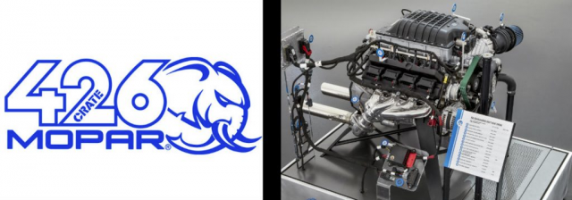

As far as rpm goes….. my current 426 is shifted at 7000 rpm. Builder said it’s safe to 7500 without worry. I have a billet crank, forged rods and billet pistons so the strength to do that is there, but it revs so fast it makes the stocker feel like a slug. We’re building a new Dart block based stroker to make some real serious power and the 411 displacement with that rod ratio is looking like the choice. I’m wanting to make it a 413 due to the cool historical factor with that 😎.

Like i said earlier ... Good parts go a long way ....

It just takes time and money!
