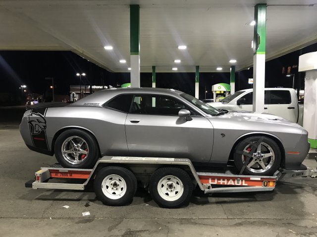

I’m loading mine up on a uhaul car hauler lol, the wheel covers in the hauler fold down so it’s easy getting in and out E6EFB0CB-FDA4-437D-9B8D-B04F050895CA.jpeg

^^ would it fit if she had bigger hips?

hellno - I saw a NB Challenger at Beech Bend 2 wks ago on one of those trailers. It looked like it was using up most of the room. I'm pretty sure my rear tires would rub the outer rails.

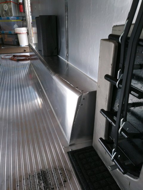

If you have skinnies on the front that makes it easier. I usually park my car in line with the ramp or trailer and then get out and go back and site down both sides of the car to see how aligned it is before even attempting to load it. If you are out of whack you pay for it down the line.......My back tires do come up into the wheel wells because my trailer has a spread axle and it is only 20' long. With the 315's I only have about 2" total to deal with. I notched and layed over the corner of the fixed fender on the right so if I do hit it , then it will not cut down the tire right off the bat. I did hit it once. Left fender is removable.

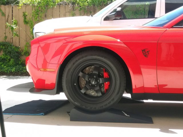

I put my car on 3" ramps in the front to be able to reach under the splitter and hook the tie downs on it. 2x12's work also. 0418191401.jpg

And I have the race ramps to load with. They are great. I also have a small set similar you yours but they don't have the radiused spots for the wheels to rest in. I'll definitely be ordering some like yours.
