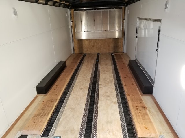

2x12’s
Simple, cheap, perfect rise.

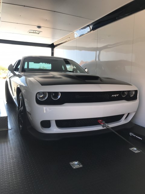

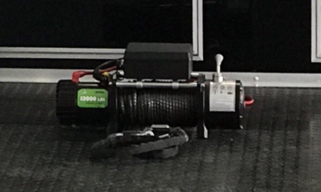

Use a winch. I have a 13,000 lb rated with a nylon cable that is very easy to use. It has a wireless remote that I can use while I walk along side the car with one hand inside on the wheel to keep it centered. No need to ever crawl into the car and that thing will drag that car in there with the wheels locked. You can get a big one like mine for less than $400. 54829732-CE3E-47C8-93E7-8D61F452D4C4.jpeg A1932C02-0630-477D-85AD-31C766B1F21D.jpeg 516C0649-93EC-4858-81B4-6DA22A7EE977.jpeg
