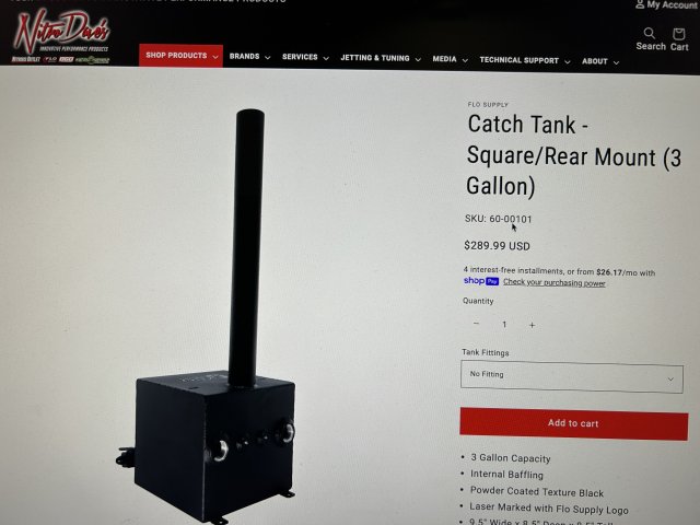

I agree. A relatively stock engine that is healthy certainly isn’t going to suffer from not having one. I guess my point is…. for a catch can to be more than just a decoration, it needs to have the characteristics that I was pointing out. My engine has really just been a stroker street motor with 9.5 compression and an aggressively pulleyed 3.0 Whipple. It will be interesting to see what the really aggressive new motor with the turbos does. I’m looking at changing to a trunk placed 3 gallon can for safety reasons concerning potential engine damage that will push oil out.
You won't regret that. I would suggest making sure that your tank vent goes outside of the car.

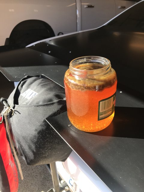

Many if not most high power cars are going to what in other circles is called the burn down tank. It vents to the outside behind the car. Usually through the deck lid. The reason is these motors have the potential to suffer a catastrophic failure that pressurizes the crankcase and they can expel gallons of oil. You don’t want that happing in front of the rear tires. I’m looking at building this into the new structure in the rear of the car. I saw that Colby just did his. IMG_6449.jpeg

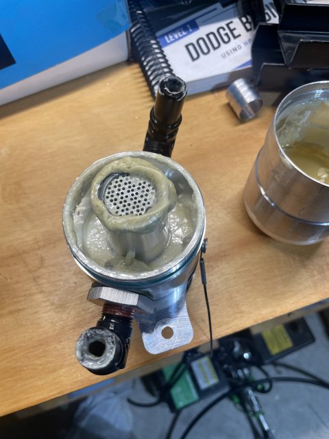

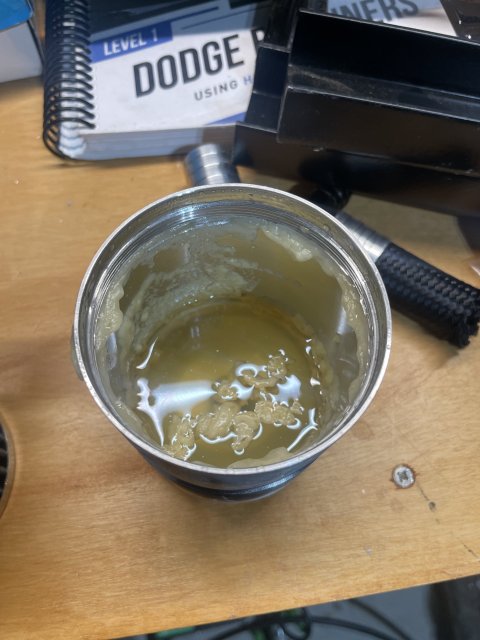

I don't agree with this at all. I'm a mid nine-ish car on a bad day. This is what is caught.
A proper catch can on a Hellcat goes a long long long way especially when driven.

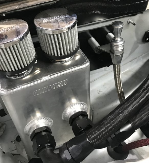

Mine catches "some", but clearly not "all" based on my intake.

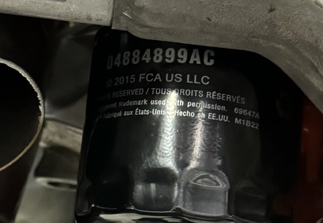

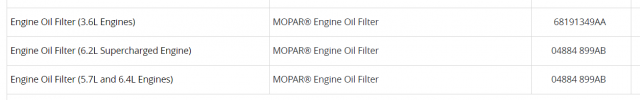

I don't see anything different in the filters other than price and pressure flow. SRT engineers designed this filter for the Viper not the Hellcat. The Hellcat oil pump is vastly different than a viper one. Just so someone can draw their own conclusions:
Factory service manual:
Have your car at a dealership, you're getting an 899 filter.

After buying a couple of 041's with center tube louvers that were barely open or even closed, I went back to the 899 which has holes. Also, micron ratings alone are meaningless. They have to be stated along with the efficiency rating to be meaningful.

One more consideration. The 041 has a dome end bypass valve and the 899 has a base end bypass. When a dome end filter goes into bypass, the oil washes over the dirty side of the filter media.
