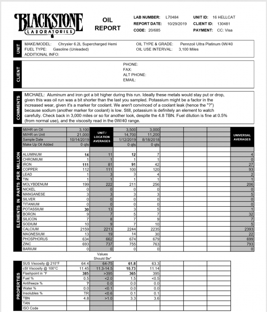

Here's the Blackstone Labs report:

Latest Blackstone report
metals have finally flushed out nicely.

Looking good Bull. Will try to have tech take an oil sample for me at next oil change...should be 3,000+ miles on OCI and 11,500 total miles on 6.2. Keep forgetting to bring kit.
