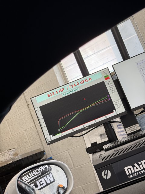

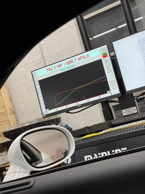

Happy New Year! Here is a fun test I love to show. This is not the first time we have seen these results and this is why I love e85! This is a 2015 Challenger Hellcat with a 2.85 pulley, dual pumps, and 1200cc injectors.
On 93 it made 762hp. Here is where it gets fun. No other changes besides the required fueling changes for e85 it made 795hp at the exact same timing and mods. This is the same timing timing and mods as 93. So a 30hp gain from just using e85! This is not the first time we have seen this. We have seen similar gains when comparing timing with 100 octane as well.
We then bumped timing up and it made 832hp on a fairly conservative e85 tune to accommodate for fuel if it is not quite perfect fuel.
