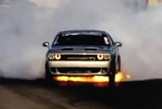

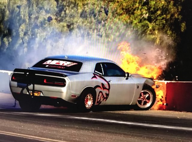

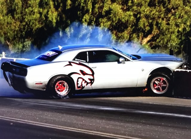

This happened yesterday on the Irwindale 1/8 mile in Calif. E886F300-17E0-47FC-A836-82AFDC5C1E97.jpeg 39E7D00F-E892-46E9-9D38-625C9AAE89B9.jpeg 05CCB681-E6DE-4BB0-8FFC-8F70902AA812.jpeg West Coast racer Tatiana Weiss had what appears to have been a engine failure in her “Growler” Hellcat. This is a built low 9 second (potential 8 second) car. She’s a experienced racer. Pictures pretty much tell the story. I’m pretty sure that she, like 99% of everybody else, was not running a ballistic engine diaper. This is why we should 😐.

It looked like the fire went out quickly and did not continue to burn. I’m not sure at this point exactly what happened, but the huge cloud of white smoke in the first picture indicates a blown motor. Damage looked to be confined to the front of the car so hopefully it will be reparable.

As long as the front frame rails were not bent it's repairable.
In that last pic I'm not so sure.

Photo number two, to me, looks like there is a huge amount of the drivers side front in/over that wall

Can’t say from the pics if it’s salvageable. After the wall, it spun onto the track without any additional contact, so the front end damage was it. The fire went out so that’s fortunate. She said that it lifted a cylinder head and then the engine blew. To me that means it breached the head gasket and hydro locked one or more cylinders. When that happens… it don’t matter what rods are in there. I know that she had a recently “built” motor with one of the new 3.0 Whipples. I don’t know whether the choice of internals included the necessary $2k head studs. That was a painfully expensive choice I had to make. I know it didn’t have the $300 diaper that would have kept her off the wall. I hope she gets back up and running with the necessary improvements.
