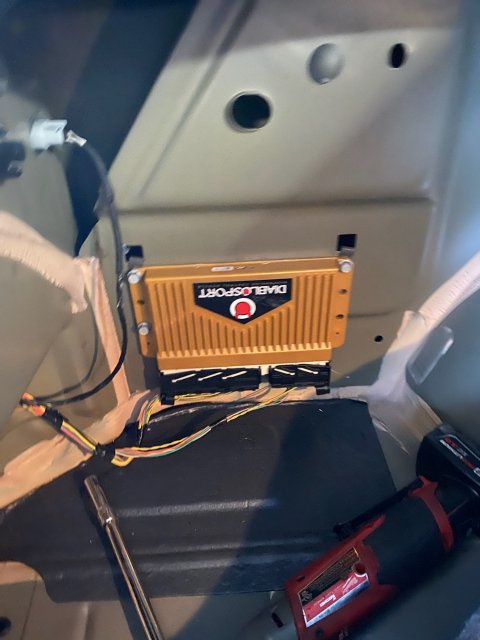

My remaining question is whether the Diablo unit can be adjusted like the DSC controller. If it can great, but until I know for sure the DSC would be my choice.
DRAGRCR
#1181
1,567
5,177
VICTORVILLE
MANGO D170
I don't think it is adjustable or programmable. It just bolts in the trunk to replace the OEM controller.
TrackDay
#1012
483
831
Great White North
2016 Dodge Challenger
One of the other threads confirms it's adjustable since it's a DSC controller with custom programming for Diablo. This is likely on my list for this season.
8,582
52,768
Come down to DCTC on May 4 and we can swap one in and out. You probably know Gary Curtis turned up there. I figured that would be a good season start and a good place to get some lap times and see if this thing does something.
