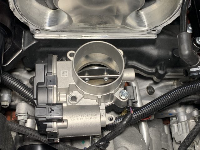

Has anyone used these to rid themselves of P012b/p00fa etc codes when pushing over 18 psi? They are supposed to be 3 Bar as opposed to the 2 Bar found on my 15 challenger. Additional information is this is on a magnuson 2650 vs the oem charger.
Part number 53010887AA
I have 4 on order and hope this solves the random limp mode condition I’ve been experiencing.

I'm sorry to do this to you. I know you have a question you want answered. I don't have an answer for you, but I do have question. I have a '09 6.1 SRT with a 2.3 Magnuson. It has the "trap door /vacuum pod" pressure relief system. I see yours does not. Did they repurpose the stock HC electronic control valve to the pad now covered by the shop towel in your photo. Thanks in advance.
P.S. my system is a 2 bar also. Can't believe they didn't upgrade to 3bar even 6yrs later and on the HC.

You are correct, they reuse the oem bypass valve there. 2 bar is ok for the stock hellcat, but you can easily pass the range of those map sensors with more boost. I hope the sensors work. Tired of popping codes. Eventually I need a retune, but want to wait till I upsize from the ID1000’s to 1300’s before I mess with a tuner.

Swapping to the new 2018+ tmap sensors will require a minor tune revision so that it reads them properly. The voltage scale is different is why.

Gotcha. Thats kinda where my research was going. Will they work without a tune specific to them for awhile? Its gonna be awhile before I can get up to a tuner in Atlanta.

I might run... but it probably won't run very well. The new sensors will output a lower voltage for the same pressure read versus the 2 bar sensors so it can even be dangerous to drive it like that, if it runs at all.

lol, man... if you didn't get my subtle hints. I highly recommend that you don't even try running without getting the tune revised to go with it at the same time.

I got your hints. Can you explain what the issue will be? Will it make it to rich or to lean base on the voltages changes? I have never messed with tuning or electronic modifications and dont know the end results.

The car will have no idea what it's making for vacuum or boost.
Picture a 0-5v linear scale from -14 to +14. Now...you install a sensor that reads -14 to +28 but the computer still thinks it's -14 to +14.

Looked into this some more. Im by no means a tuner but my ecu is unlocked by hp so I figure buying the hp tuners with appropriate credits I should be able to rescale the map sensors fairly easily. We shall see.
