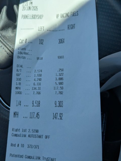

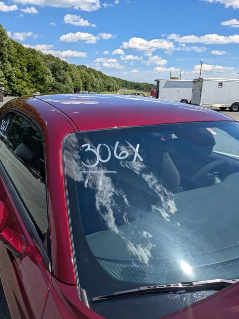

Based on Ron's recommendation, had the local Dodge dealer install the tune on Friday, went to Cecil today for test and tune. No or very little prep, greasy surface and 84/85 degrees. Spinfest launching on 1st gear so launched in 2nd gear. 9.30- the tune is good. Stock car.

WTF were you racing .. 1.9 60 and a 9.5 at a crap MPH?
And nice run

A Fox body mustang was in the other lane, it was missing a hood and was blown or turbo, I was waiting for him to blast by me (most likely had a LS motor- they almost all do).
I am down to two (2) tracks, (Atco and Englishtown are gone) and because of costs, there is very little track prep for test and tune events, so it appears. I am probably giving up on 1st gear launches at test and tune events. Ron gets the fly paper prepped tracks, I get the ice skating rink (I know for $ 30 to $ 60.00 entrance fee you get what you get and like it).

Hope to see you at Cecil or Maple grove?
I mostly race Mason Dixon but love them other 2 tracks.

Within 1.5/2 hours, its Cecil, Island or Maple Grove. Never been Mason Dixon, the 170 is growing on me, so much less drama running a car stock. Speedy mentioned purchasing the extended warranty on his 170, I may do the same.
Yes, my go to (now) is Maple Grove or Cecil. Island has a ridiculously short shut down and if you run out, its over a ravine. I ran 8.96 there 6 years ago (in my hellcat) and burned the brakes up in the shut down.

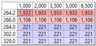

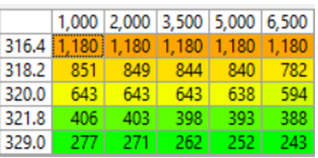

I need to find a copy of the new cal to compare to original. Glad it's working well.
SENT!

Thanks! I'll run a compare against the original and see what I can see and report back.

I'd love some screenshots of parameters
