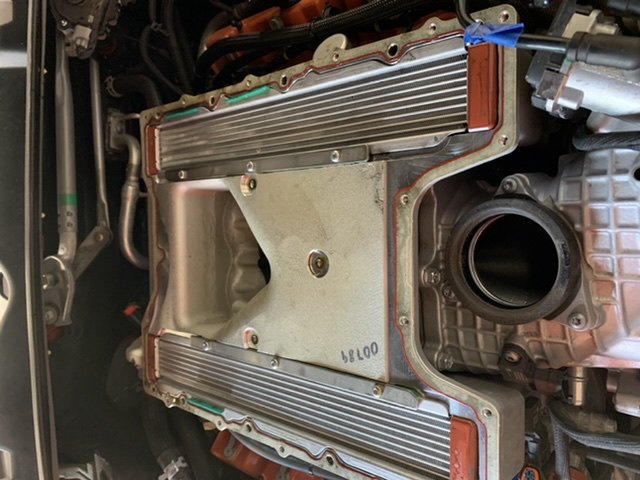

I wish I would have paid more attention when I pulled it apart over winter. Not that I’m aware of. But the cars used so maybe it was at some point. At first I was worried about a lower but i don’t believe that was it. I was talking to the wife about it this morning and said maybe it’s ported. I guess what would be the best way for me to tell if it is ported ?

5FC3BC2B-ACEC-41B3-953A-BD87E9790DE1.jpeg 7DFC87E5-9818-46B9-B32B-62F0EBE920C4.jpeg 5A68A0DD-BFDB-4A54-823A-22FCF2F47D47.jpeg

Does your car have a bigger throttle body or ported blower?
I took those pictures but that prolly doesn’t help much.
I would say looks stock.
you would know, much smoother like this
https://www.dusterhofftuning.com/products/jokerz-hellcat-supercharger-porting-service
