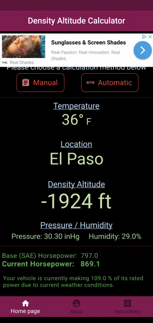

Here is a screenshot of what the app tells me the DA is currently. It spits out a projection of what the cars performance should be. However, the numbers aren't even close when you add the elevation.

Try AutoDens app
