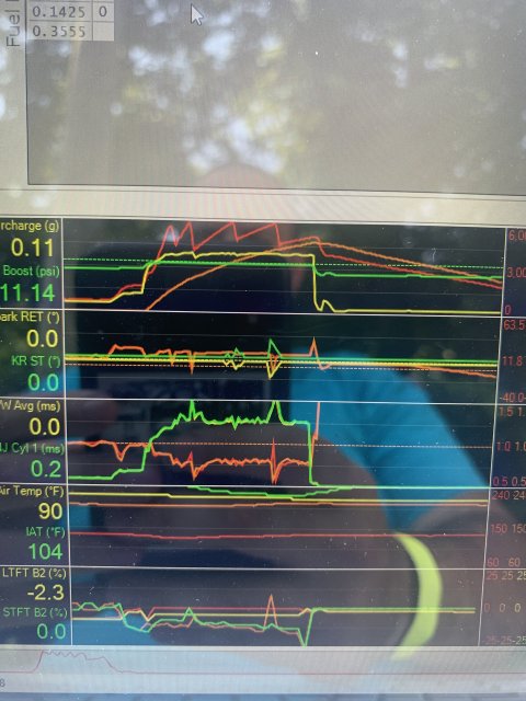

At the end of the run I’m at 5125 in fifth. Just want to know if I’m wasting my time and should revert.
11.05@122 1.64 60ft and 11.06@122 1.65 60ft. Videos soon!

On stock boost & tune, those shift points are correct.

Cecil Dragway is not known for their prep. It was okay...
First two runs were with those settings. Tried old school way of track with traction control off, paddle shifters rev matching. Looked at the logs shifted the same way Ran an 11.08@125 1.683 60ft. As the day got hotter it wasnt fun, track was getting hot. Last two passes were 11.15@124 1.687 60ft and 11.17@121 1.694 60ft. Left at 1500 and just got home. Will be uploading data logs, video and mich more. For 101 track temp this car did just fine and owes me nothing.
