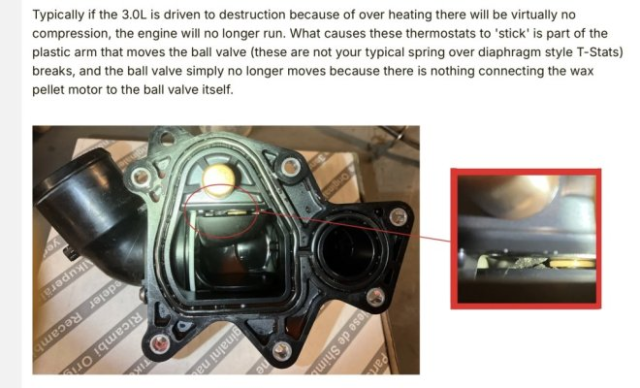

Those I6 motors have lots of problems it seems. There was a Grand Wagoneer getting a motor replacement in the bay next to my 170 when it got new spark plugs. Whole body was off the Wagoneer for the swap and parts scattered everywhere. No clue how they'll get it back together properly.
The culprit is the ball thermostat design. There was a part revision for 2025.
