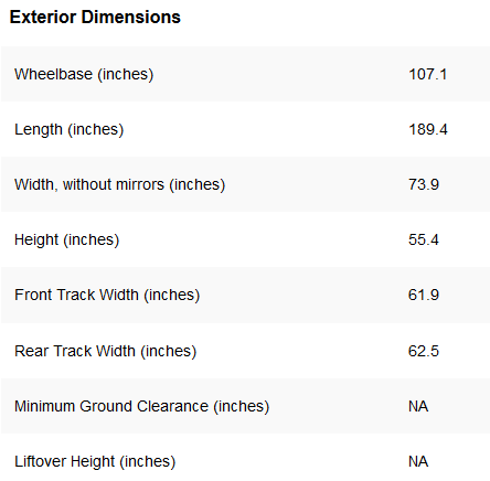

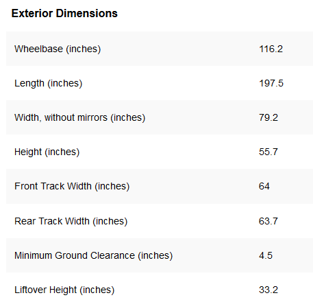

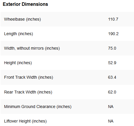

Super guicci spec sheet numbers aside there is a lot of consideration that has to be given the physical dimensions of these cars before condemning them for any single performance metric.
Widebody Hellcat Challenger:
ZL1 Camaro:
GT500:
All of the above specs are straight from C&D's website so I accept no responsibility in their accuracy. With that out of the way consider the wheel bases between the cars there is as much as 9 inches of difference, and then the total length is about 8 inches difference between the 3 cars, and then the track width varies by an inch or two. The Mustang being the dimensionally smallest of the 3 cars. So what? Well there are the compromises that comes with that (room kids, trunk space, ground clearance, comfort, ground clearance etc) - but who cares about these things when you want to be the best handling car (that you could track but never will)?
It comes down to, in my opinion as a quick and dirty determination, the wheel base to track width ratio. The rule of thumb is a 1.7 ratio is the ideal (not including other factors like moments of inertia, CG, roll centres, weight transfer, tires, etc) for a car with favourable handling characteristics. Only 2 of the cars above, have this designed in; and it is not the Challenger. The Mustang comes in at 1.7218, the Camaro at 1.7656, and the Challenger a very distant 1.8213.
So yes, you are ineffect literally splitting hairs when comparing those two cars which have been engineered to perform at the absolute limit (which most will never see).
