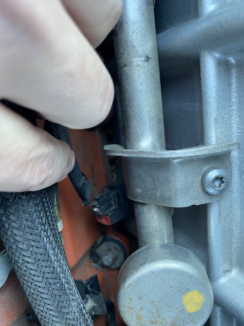

Took my Hellcat out this morning after about a 6 week hiatus. Noticed it was driving a little funny, but figured it was sitting a while and a bit colder than last month. Popped 2 CELs for Cylinder 3 misfire and Cylinder 3 fuel injector circuit malfunction.
Pulled the cover off and found this lovely site. Can this even be repaired? Could I solder the connection and wrap it up?
Or do I need a whole entire harness? Can’t imagine those are inexpensive.
Don’t know how that could’ve happened other than a critter getting in there, but I don’t see any damage elsewhere. Plus that hasn’t ever happened to any of my other vehicles.

That seems too close to the connector to be able to repair?
But if you can get a short pigtail and connector, then you could splice it in.
Yup, when I went back and looked at it, it didn’t seem repairable
Probably rodent or squirrel tried to stash something around there. I'd check other spots for possible nuts or rodent nesting material.

I did see some broken acorn shells around the area, so it definitely seems like so.
