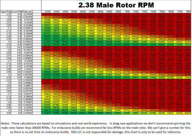

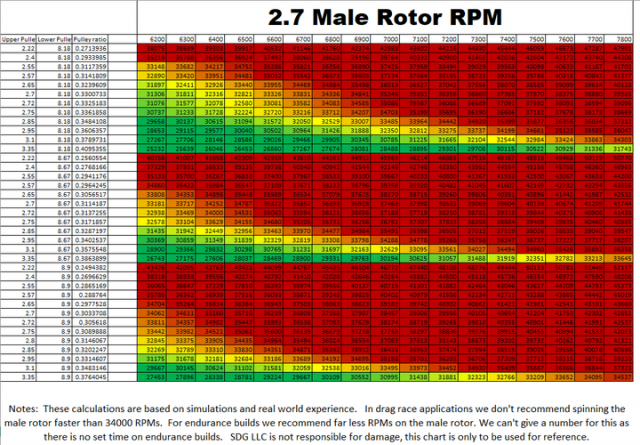

Is there a chart/calculator where you change blower pulley size and crank pulley size for blower rpm? Vortech had one and you could see by going to a bigger lower and bigger upper you could run the same blower speed then just using a smaller upper
As an example, if you ran just a 2.5 upper compared to a larger lower with a 2.7 upper may be turning the blower the same speed at 6,000 rpm but you would have a bigger upper so less chance of slippage.

Something like this perhaps:

Yep, and I found another

ATI diameter seems to be disputed?

FYI: I got this straight off of the ATI website:
  • #8: Adds 3 PSI. Requires 59.4" belt: Gates K100594HD. A/C bracket may need grinding for clearance.

Interesting since the ATI is suppose to be 10% which would be 8.80
