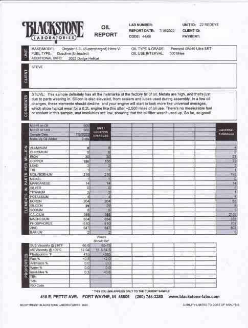

The lack of commentary is why I stopped using Oil Analyzers and moved to Blackstone. You can also call Blackstone and get a savvy person on the phone quick when needed.

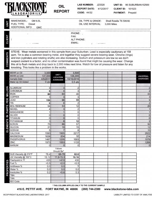

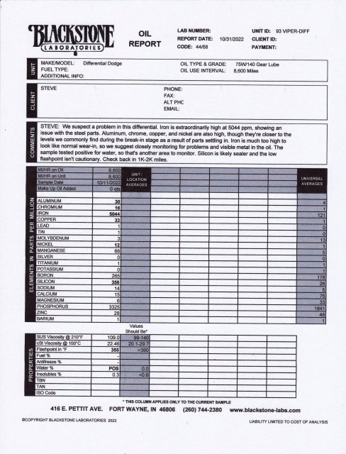

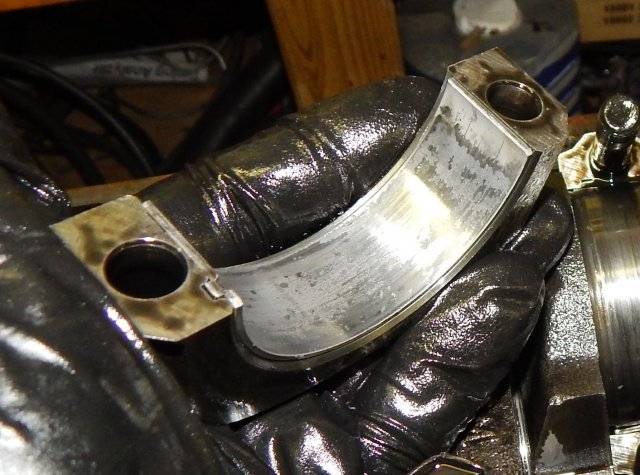

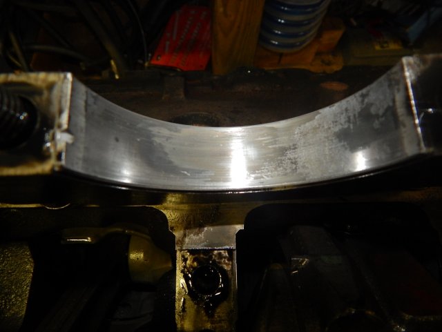

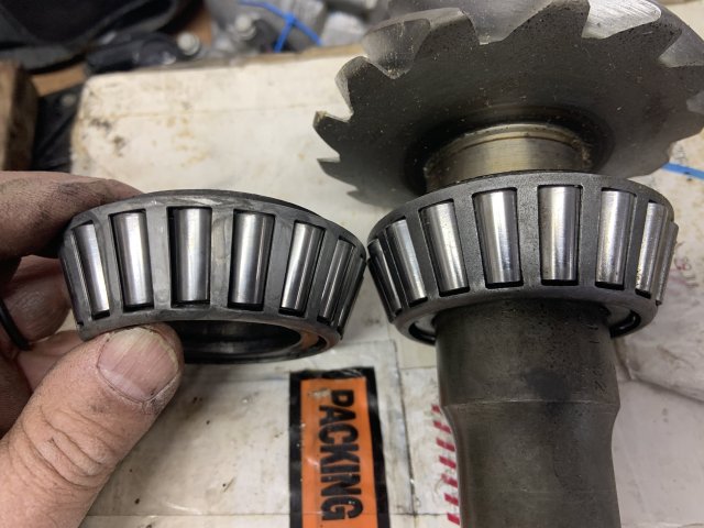

Yup, the Blackstone labguys were so excited when I sent them the autopsy photos of my 6.5 diesel's main and rod bearings. And again when I sent them the pinion bearing photos. They love to see their predictions going to good use: like saving your cross country vacation by letting you know you need to swap engines before you go or you're gonna wind up on the side of the road spending all your vacation money to get your truck towed back home.
