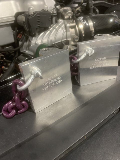

Got a new tool a while bsck, worth its weight in gold for a one man show

Supercharger lifting blocks
Bingo! That was faster than I thought lol

Goes under the side of the lid on each side, and a dowel screws down into the open bolt hole to secure it. Use an engine hoist, and blower comes straight out. No more fender elbow dents!

It’s made by snap on for the dealer, I’m surprised they even released the tool to me

It’s on mopars dealer tool site, let me take a pic of the part number on the side

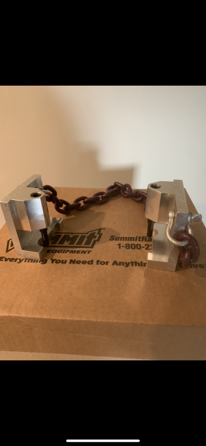

16,880
52,878
Well shit, it's on top of a Summit box, are you telling me it can't be had from Summit???
Tease...
Tease...
No sir, that was just from other parts lol
