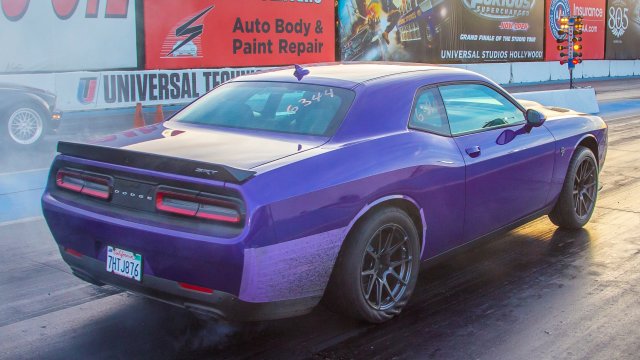

In the rain, the ET STREET R's literally must be driven at 45 MPH or less. I would go with the ET STREET SS 305/40R18 and you literally have to NOT stand on it when driving on the street. Sure you can drive normal and keep up with traffic but if you are WOT even in the higher gears those tires WILL wear out in no time. I would also keep the burnouts to a minimum on the track and be agressive on the pressure to compensate. I would shoot for 14-15 hot.
This is that ET STREET SS @14PSi hot and it drives fine down the track......
