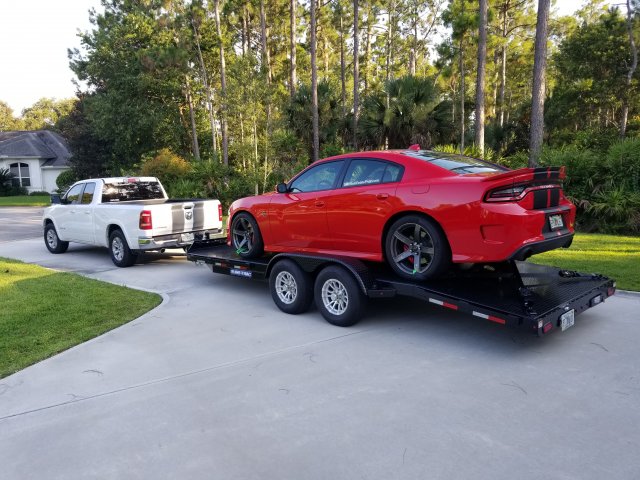

Is that a Ram 1500? And didn't you just sell an enclosed trailer?
These were before them. 1500.

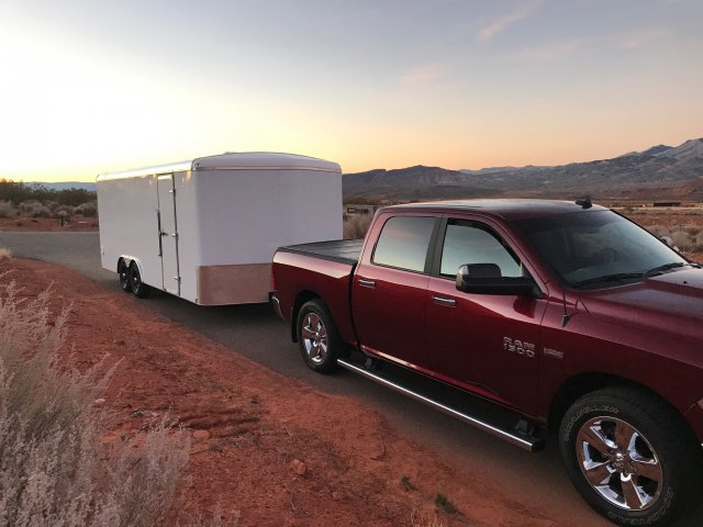

I towed with both a basic open and 20’ basic enclosed with my 1500. You do not need a tilt. Raceramps to extend the ramps for loading and a winch. I never drive my car in or out of the trailer. It’s safe with zero risk of fkn it up and gives you the capability to load the car if it breaks. It’s a one man job. I’m out west where the roads go up and down (grade south of Vegas is 17 miles long). 64A6BE18-6362-457D-A70E-2BC38F02D592.jpeg

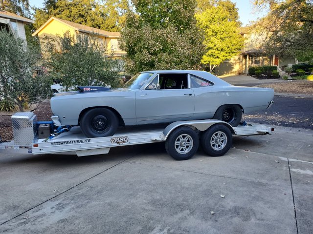

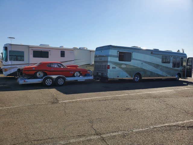

My 18' (technically 17.5') 10k Featherlite is 1585# I only bought it for when I want an open trailer behind our 40' pusher. My real point though is I towed the road runner all over the place prior to that with a 1997 Dodge Ram 1500 and it did well and that was with an older steel 18' tilt trailer. Most modern 1500 should have no issue towing what you want to tow.

I towed with both a basic open and 20’ basic enclosed with my 1500. You do not need a tilt. Raceramps to extend the ramps for loading and a winch. I never drive my car in or out of the trailer. It’s safe with zero risk of fkn it up and gives you the capability to load the car if it breaks. It’s a one man job. I’m out west where the roads go up and down (grade south of Vegas is 17 miles long). View attachment 121404
Good info. No WD hitch?
