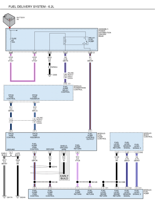

I'm looking for the wiring colors and pinout details for the FPDM (fuel pump delivery module or fuel pump control module) connector on a 2016 Hellcat (or similar). Anybody got access to Tech Authority and can grab it for me?
It'd look something like this, and have a picture of the actual plug with numbers on the pins and what they go to like power ground etc.

Is this of any value? this is in the Charger electrical diagnostics manual ...
6,915
17,838
@HWDan super helpful. Thanks for providing this info. I'm trying to determine which pin on the FPDM connector correlates to the fuel pump relay. Looks like pin "A".

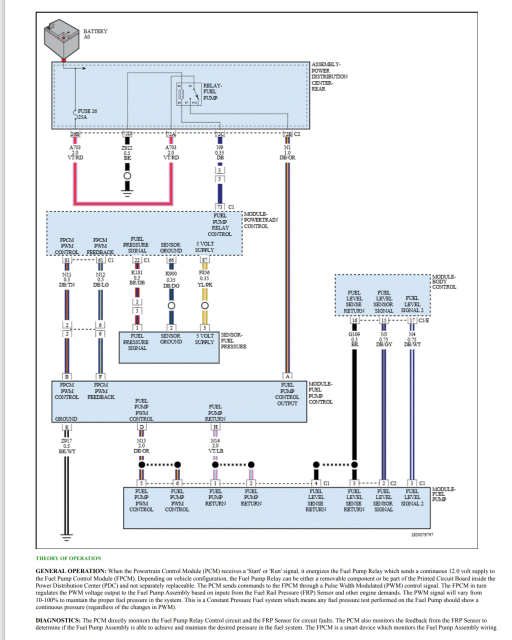

@HWDan is this in the documents you posted? I can't find it and was hoping the pages before or after may help me. I see a couple things different than mine for example Fuse 26 in the diagram says 25A but if that's indicating the fuel pump fuse that's Fuse 21 in mine and it's a 30A.
I'm also puzzled by the description on PIN A of the FPCM (the dark blue and orange wire) indicating an OUTPUT when it's obviously being fed by the fuel pump relay making it an INPUT?

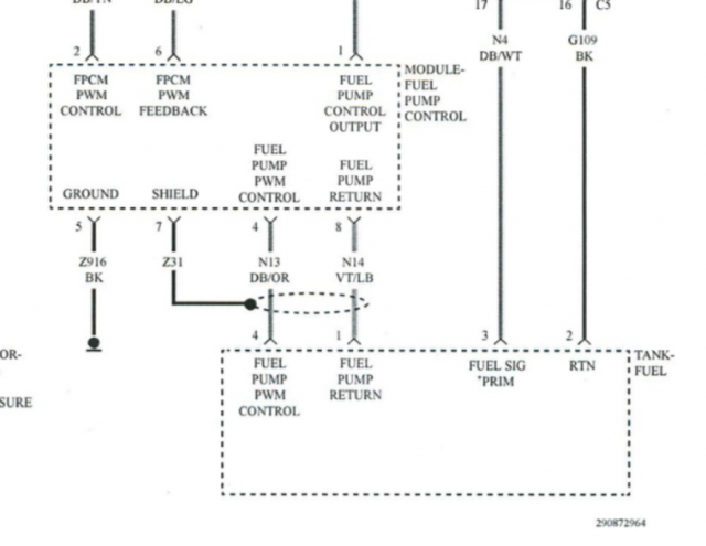

From 2016 connector database:
Maybe there is a difference in the Charger here?
I trust that now @Chuck and @Diboblo can pinpoint exactly what you need to see.
(although even Diboblo's PIN diagram shows A dark blue/orange as the output unless the terminology is reversed depending on perspective)

is that what you need
6,915
17,838
Thread Starter #20
That's lining up with other diagrams so I think that's what I needed. Thanks for the help all.
