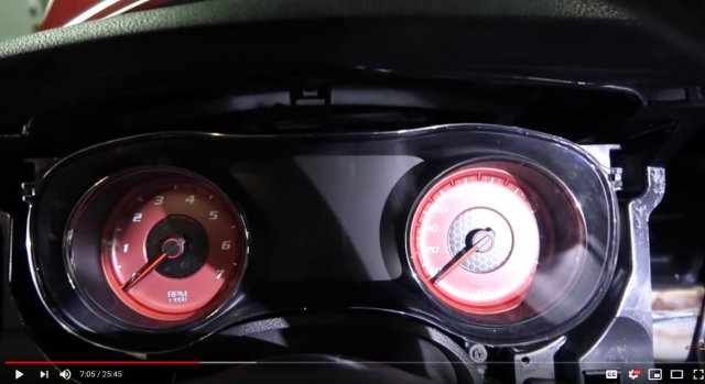

Consulted the Youtubes and I believe I may have been misled. Just need a panel tool and a butt-ton of machismo to rip the whole gray carbon-fauxber trim piece off and it looks like I can get to the meat and clean this puppy!

This video shows the ENTIRE process. You can actually get the clear piece off completely for cleaning/polishing. I'm going at it Friday after work with some Plast-X polish and a microfiber cloth to get it CLEAN

Yes... the entire faux tooled plastic bezel comes out, then the speedo has 4 screws that hold it in place .
Once removed, there are several tabs that hold the speedo bezel in place. No tools necessary, to remove the speedo bezel.
The dash bezel, on the other hand... that takes some nerve and patience.
