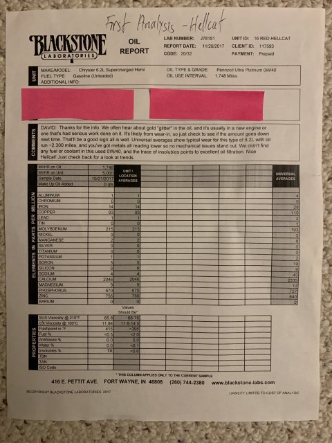

I’ll have to compare that with the Pennzoil I had them do. If I remember correctly there were some minor differences. Probably doesn’t amount to a hill of beans.

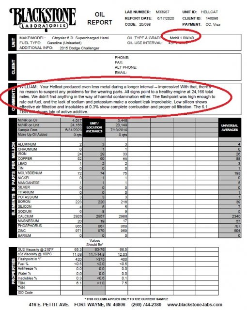

One thing I notice now comparing the Mobil report above with my Pennzoil is the molybdenum contents. The Pennzoil had a whopping 215 while the Mobil only has 72-75 while the universal average is 193. Another difference is the Boron level of the Pennzoil is only 5 while the Mobil is around 220. Universal average is 19. That’s also a huge difference in the other direction. Maybe they both do a similar job and Mobil chooses to do it with Boron while Pennzoil does it with Moly? D54E91ED-FE5B-4CBA-BD69-CF92420ACFE7.jpeg

I change my oil about every 1000-1500 miles, when it starts getting black on the stick I drop it. I also cut the oil filters open and check the pleats, a oil filter cutter makes it to easy to not too. The filter media in these filters is almost 6 ft long when pulled out!! I run my car hard, it doesn’t get babied. I buy all my oil for all my other cars at Walmart including Mobil 1 15w50 high ZDDP oil that I use in my solid lifter 69 302 block, can’t beat the price for 5 qts. And I’ve eye balled the 0w40 Euro spec many times and thought about using it in my cat since I change the oil 3-4 times a year in it. I may give it a whirl next change especially now running 85% ethanol after seeing that oil report, THANKS for posting.
