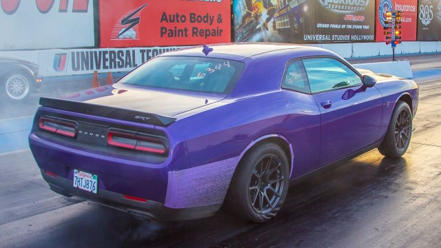

That is a pretty serious tire. I think it is likely you can just stomp the throttle wide open and dead hook on a well prepped surface. But you MUST get a solid burnout and get the tire pressure right. I had the 305/40R18's ET STREET SS on my Hellcat and I could dead hook on marginal prep. It has nearly the same sidewall as your tire and was quite a bit narrower. MT DOT Drag radials should use 14 to 18 PSI HOT. Yes you can use 20 PSI if you have 350 horse power. Yes you can use 20 psi if you have a race radial slick that is designed to run that pressure. Yes you will be SLIGHTLY faster running the most pressure that you can RELIABLY hook, but you CAN go down to 14 HOT if needed. But this tire on your car needs to be 14 to 16 HOT. SO, set them at 15 before your first run and get them to roll smoke for 4 seconds. That should give you 16 HOT and be a good starting point. I do my burnout in manual to control wheel speed. But if you leave it in drive you have to watch the throttle closely to maintanin wheel speed and not over do it by letting the shift up to 5th gear or something.
I put the car in manual and then boot the throttle and the car will force a shift to second and then the rest of my burnout is in second gear at high rpm, like 5500 to 6000. If you are not aggressive then you will have to pull the right paddle to shift it to second or third if you prefer. Once you see good smoke count to 4 and then release the brake and ease way up on the throttle and drive the burnout forward and let the tires recover (grab). PUT CAR BACK IN AUTO, then stage.
If the car hooks, then you can let the tires pressure increase naturally up twoards 18. Just check and equalize them immediately after each run when you get back to your pit or staging lanes. If it spins, re adjust back to 14, 15, or 16 as needed HOT. If the car sits and the pressure has dropped a little too low, I many times just extend my burnout to get the pressure back up, since I am lazy and do not want to break out the air compressor. If the car does not hook at 16 HOT then you need to try lower pressures like 15 or 14 and extend the burnout some.
ET STREET SS 305/40R18 @ 14.5 psi
